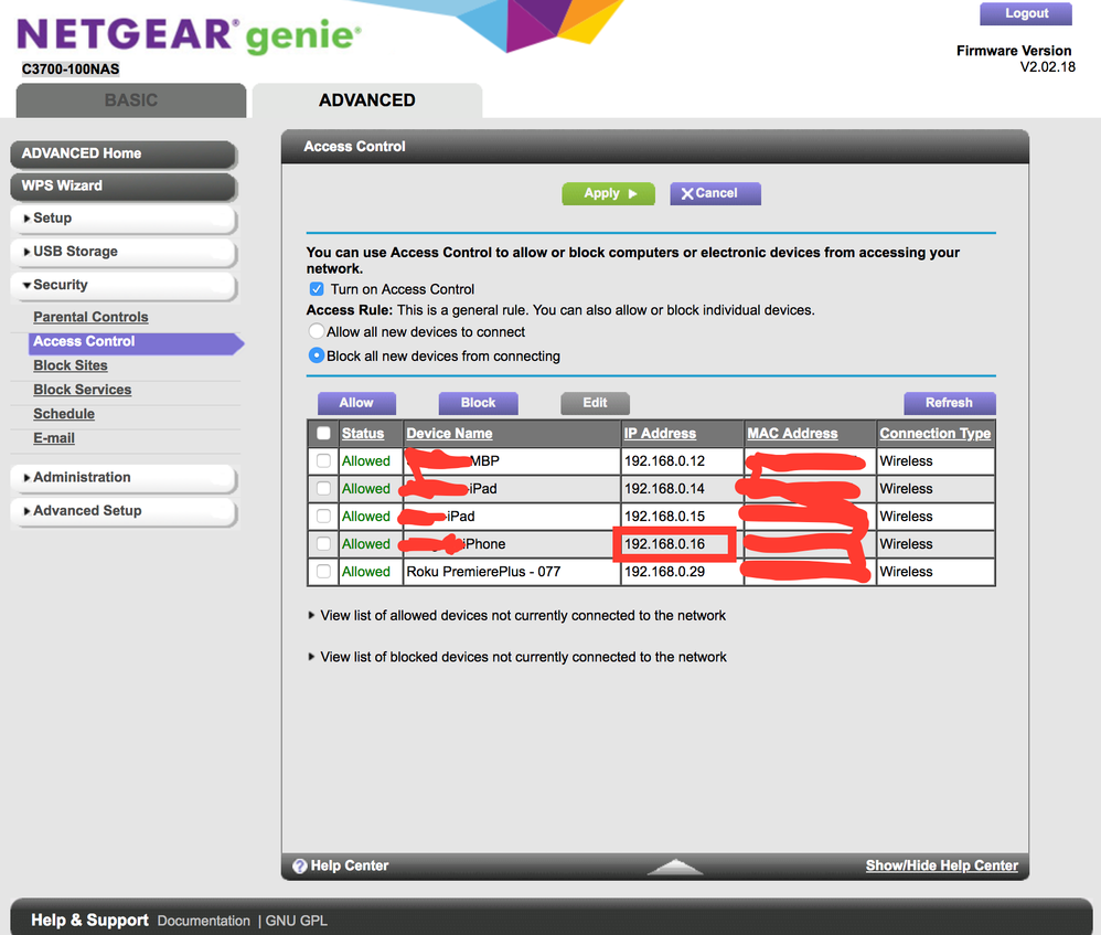

C3700-100NAS Router forwarding my traffic to Africa IP when my or my wife's cell phone connects
Greetings,

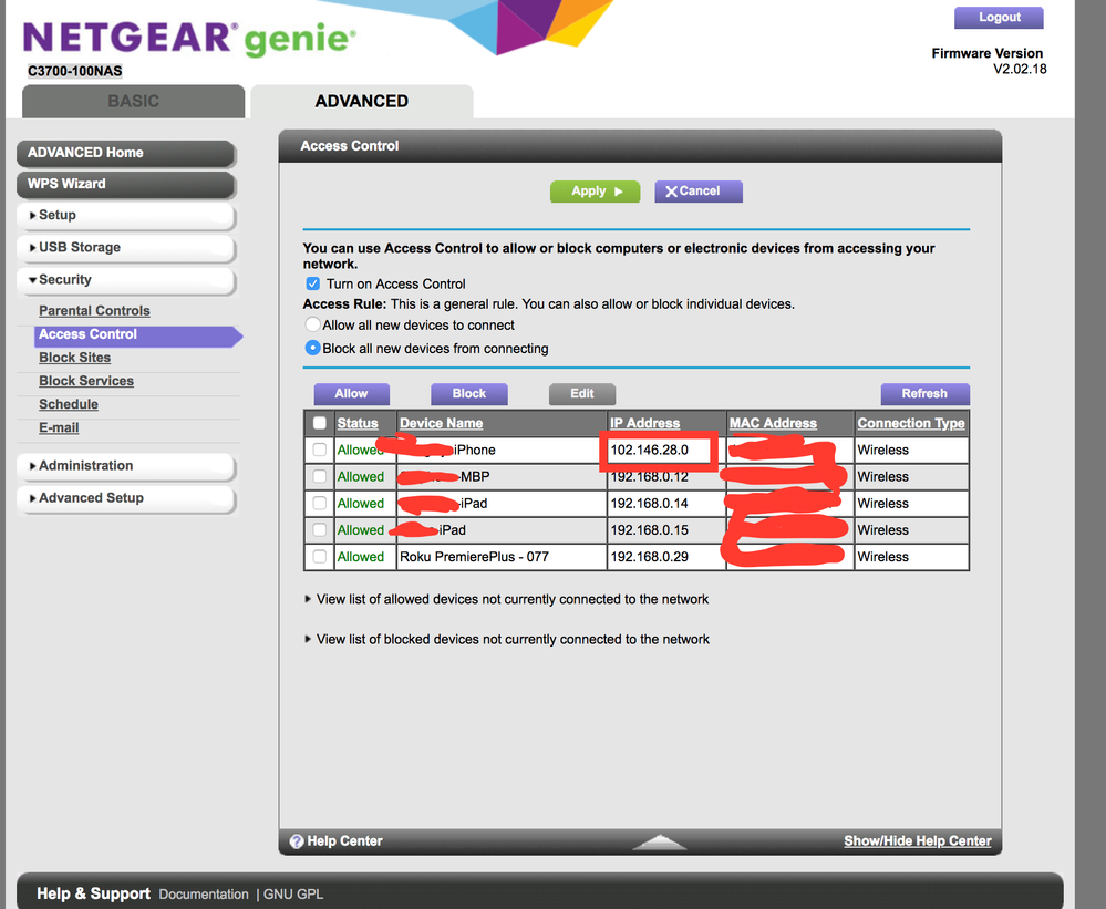

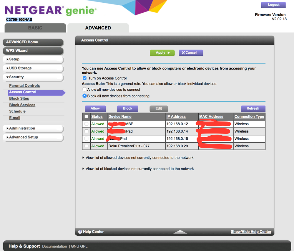

I think I have a serious security breach, but I can't figure out if its the router or our i-phone's that are infected.  I'm thinking more towards the router, because I have attached screen shots that show before my iphone connects, after my iphone connects and it is given a normal private ip in the 192.168.0.0/24 range, then in a few seconds if I refresh the private ip changes to 102.146.28.0!!!
I did a whois on that IP and it is from an ISP in the Africa Region!
If I turn off my wifi on my phone then and refresh the list of devices again it will of course go off the network and not be seen again until my iphone or my wife's connects to the network.  The phones still receive the proper IP though of that private range so I think maybe I got infiltrated by VPN filter big security issue recently, but I have followed the steps to get rid of the malware by factory restore then upgrading with the bug fix from Netgear and then locking down all access except for my known devices mac addresses.
I installed antimalware TotalAV on my macbook and my iphone along with a VPN to encrypt my traffic on my iphone.  They didn't find anything at all.  Do I just need to buy a new router?  And any idea what is causing this?refresh after initial connectionno iphone connectediphone initial connection

        Do you see the same strange IP address show up in the router under Advanced/Administration/Attached Devices?
        Also, what are the settings under Advanced/Setup/LAN Setup?  DHCP address range?  Do you have any Address Reservations set up?
