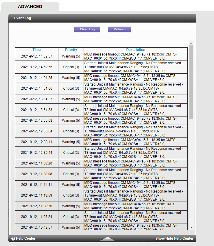

CM500 Cable Modem Downstream Constantly Flashing Green
My Modem Details:
Hardware VersionC312T00-01
Firmware VersionV1.01.12
Cable Modem Serial Number48L50B7FA3805
CM CertificateInstalled
CM MAC94:a6:7e:18:35:bc
My Issues
For the last week I have noticed download speeds have been a little troublesome.
I browsed some discussions here and found people posting their modems logs, so i thought I'd take a look at mine and i see CRITICAL and WARNING everywhere.
I have no idea what the language means so i felt posting here was the best solution to hopefully rectifying why the downstream light keeps blinking green
Modem Logs

  • Your logs are indicating line issues.
    do you have a screen snip of the cable connections page?
    Check for splitters, signal attenuators, and amplifiers in line. Remove them if you do.
    check the line for kinks, damage, old/loose/bad/corroded connections and replace them if needed.
    I'd move the modem to right where the coax enters the home and connect it there.

      After checking the cables I find no erosion ordamaged cables, and I do not have any splitters, signal attenuators, and amplifiers.
      the modem is as close to the coax entry point as physically possible.
      Could there be a damaged line outside?
      I speed test and i get acceptable speeds yet sometimes a website on my desktop will show a DNS failed page buit then within seconds suddenly appears to load the page....
      I have attached a screen capture of the connections page
