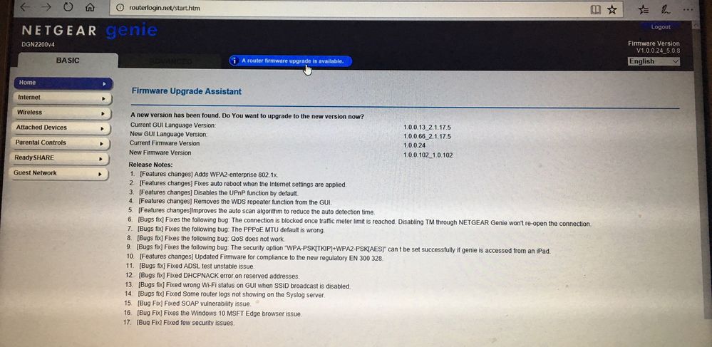

I wonder if someone can help. I received an unexpected email from NETGEAR Security advising of a firmware update. When I log in, under Advanced, Administration & the
Router Upgrade tab, the Firmware Assistant confirms the update available but there is no "Yes" tab visible to click to perform the action.

  • Hi Antinode, I appreciate your reply. In answer to your questions, the email was sent on 31.3.18 from the address:
    NETGEAR Security [[email protected]]
    The router model no. is v4
    I've accessed the downloads/documentation page. I actually tried downloading the listed update:
    Firmware Version 1.0.0.102 (All Regions Except Germany) earlier in the week but was unable to extract the files. This made me worry that the whole thing was phishing or malware. I'll try to attach a screen image from the NETGEAR Genie page - is it the fact that it's the Genie page that means there's no "Yes" tab to accept the router firmware upgrade it advises me is ready?

      > [...] is it the fact that it's the Genie page that means there's no
         You lost me.  If you scroll down and there's no kind of "proceed"
      option, then I'd go to some place like: ADVANCED > Administration >
      Firmware Update, and do it manually (after you get the ".chk" file
      extracted from the ".zip" archive).
