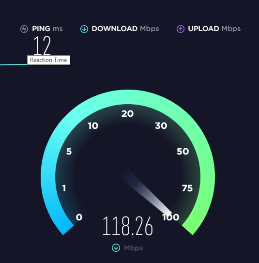

      Here is my current speed test:
      I will update you all again if all seems to last.
