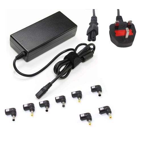

    Some generic adapters come with a set of tips that will fit a range of different devices.
    Generic adapter
    These things are pretty common, so first check to see if you have something compatible lying around.

      I'm aware of the multi-plug generic adapters, and I also already checked some of the old adapters I still have.
      I would really appreciate it if further answers focus on my exact question on finding the required size of the plug.
