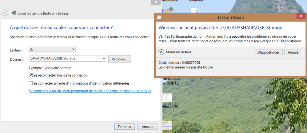

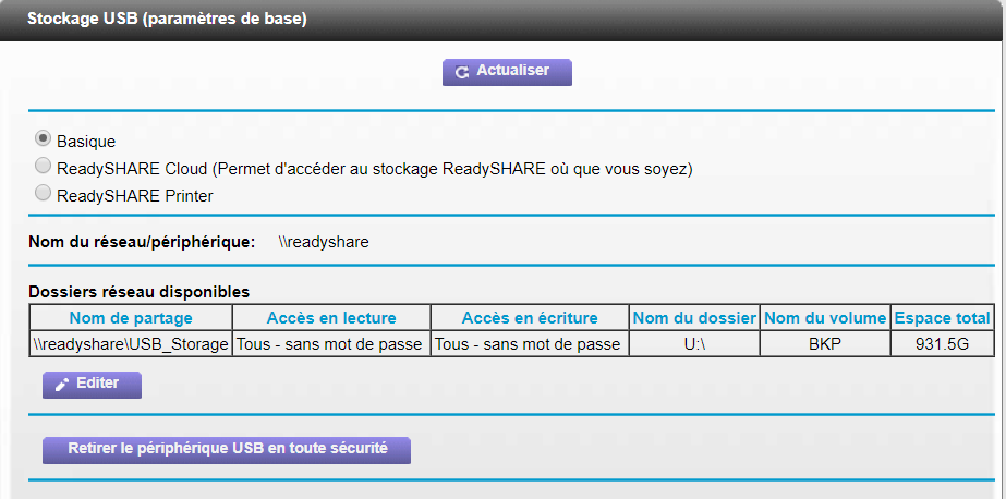

The router sees the device (shows the right size and volume name) but when I go in File Explorer to connect to a network drive I get error 0x80070035, sying the it cannot find the path to it. Netgear USB Control center V1.36 does not see the device. Any suggestions?

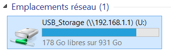

  • I used your first sugestion/question and got to work. See the joined picture.
    Thanks

      1. Are you able to access it when using the IP address (\\192.168.1.1)?  See attached file

      5. Have you tried using another storage device (flash drive, another external drive)? Yes, with no success. See attached file.
