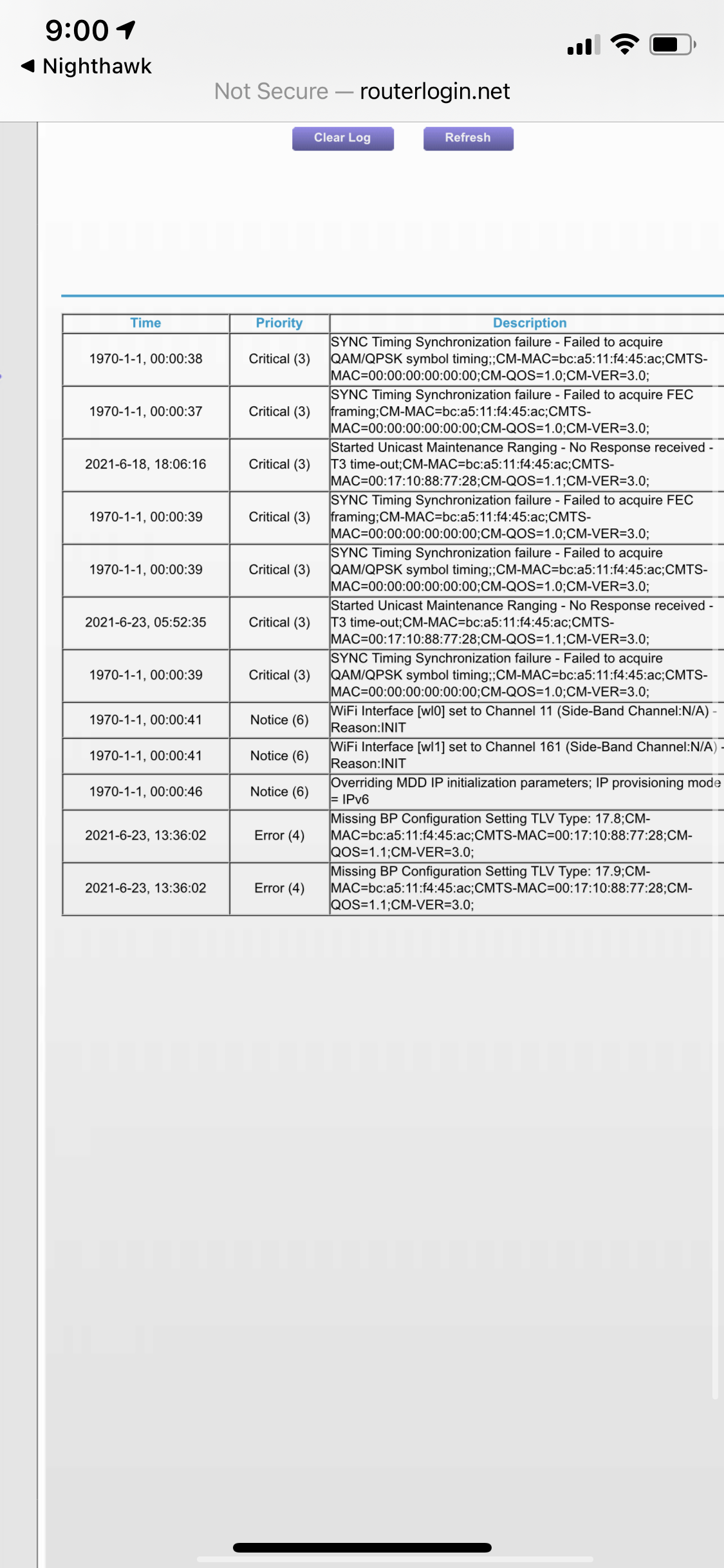

I have this modem router for about a year since the pandemic but recently, within the month and half, I've noticed that it's been dropping connection.
I isp is Spectrum in NY and I called them and they said that there was coding on their end that could be the problem since the coding made the service look for a former spectrum owned router (not my current one).  they removed the coding and I rebootted my machine.
After a few days, I still see dropped connections and the event log indicates that critical failure.  It haappens 3-4 times a day and I've noticed it when I'm on zoom and my wifi goes on the blink.
I have a splitter that allows a connection to my modem/router and another wire connectio to my tv/cable box.
I need hlep in fixing this problem.

    do you have a screen snip of the cable connections page and the event logs? that helps us to check the line
    do both wired and wireless devices have issues?
    • wen252's avatar
      wen252
      Here goes

        and the cable connections page? shows upstream/downstream power/errors

    • wen252's avatar
      wen252
      Heres cable connections readout
