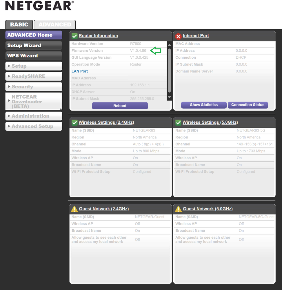

  • FURRYe38's avatar
    Pulled out my R7800 and can still access it's web page from Windows 11 PC using MS Edge on last version of FW released:
