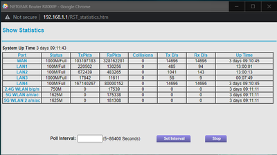

  • plemans's avatar
    plemans
    have you logged into to see what speeds the ports are connecting at?
    How do I display Internet port statistics on my Nighthawk router? | Answer | NETGEAR Support
    If they're only connecting at 10/100mbps speeds and not gigabit, then try a short 6ft cat 6 cable. Maybe you're runs have issues on the connector ends or the cat 8 might be causing issues. I've seen devices not connect at gigabit with cat 8 because cat 8 tends to be a bit pickier with how well the connectors are made.
      • plemans's avatar
        plemans
        try swapping the port that is connecting on gigabit speeds to a different port. See if it switches. If it switches to gigabit, then it isn't the router.  That'll narrow it for you to either a line or device issue.
