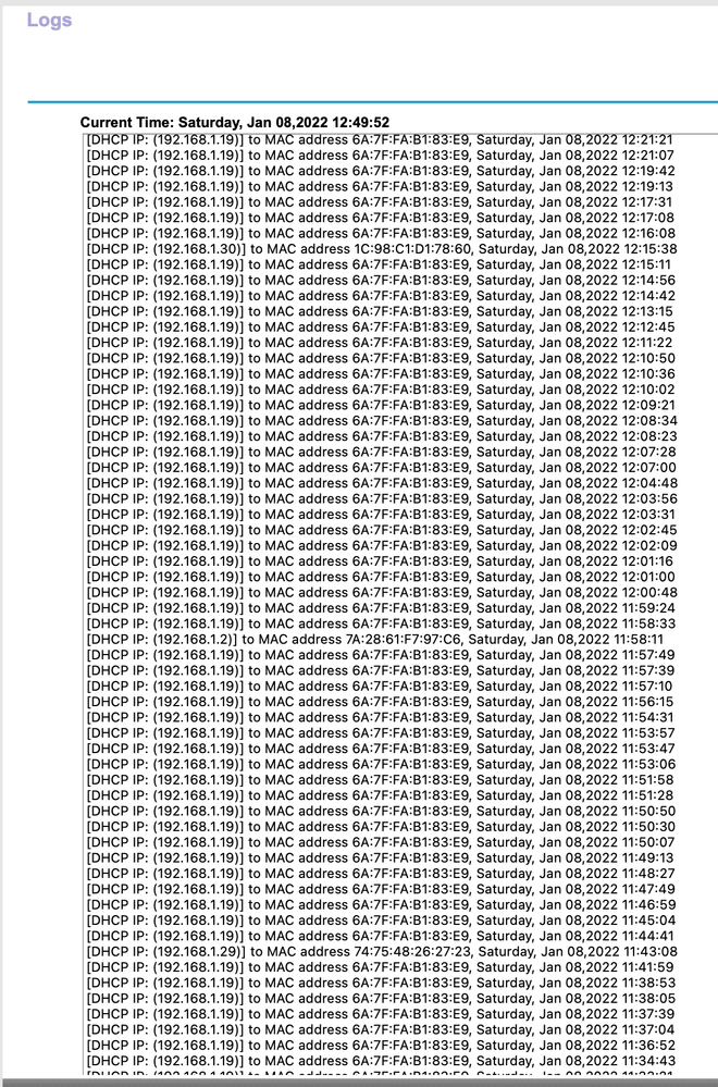

Recently I discovered the router logs are weird. I have attached a screen shot of them.
One device seems to keep being assigned IP addresses by the router every 10 seconds up to a few minutes, this is constant.
What could this be?

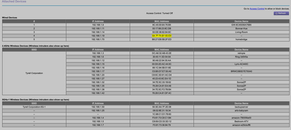

I decided to look at the attached devices list to figure out what this device is, it usually doesn't show in attached devices, but when it does....
Plugged into the secret 5th ethernet port?
It shows as being one of the 5 wired devices, which is kinda odd as the R8000 only has 4 ethernet ports and I am able to identify the devices connected to them.
What on earth can be causing my 5G-1 to be so bad, and what is connecting to the mystical 5th ethernet port?
