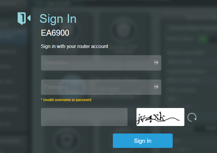

Hello, I hope someone can help me with this weird issue. I had a Netgear R7000 router on which I wrongly installed the firmware version EA6900_386.7_2 (the linksys one) .
The update was successful but after the update only the red light(on the power) is glowing and I am neither able to login to the web GUI/ App with the username/password which was working earlier.
Even I am not able to factory reset the router using the reset button. I try to keep it pressed, but nothing happens .
I am kinda stuck with the router with the wrong firmware version and I cannot roll it back as I cannot connect to GUI.
Does anyone have some suggestions for it?

Thanks for the reply guys , I was able to solve it as the linksys firmware needs to be reset while rebooting the router. I did a factory reset changed username and password , and the installed the correct firmware version on the router to fix the issue . been a hassle though 🙂
