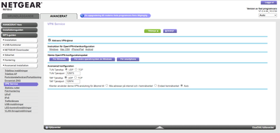

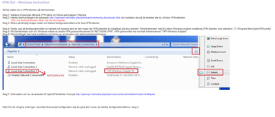

Can not get OpenVPN to work... I have followed the instructions below.
see attached log file... something about "TLS error: Unsupported protocol."??

- KitsapMaster
For test purposes, suggest you try the configuration as shown in the attached screen snip. After you make the changes, you will have to generate your client configuration files again and transfer them to the client.
Make sure you are testing your connection from a client device that is not connected to the same network where your router is running the OpenVPN server.
