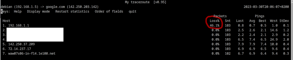

I have r7800 with firmware V1.0.2.92 installed. Do other users of this device have the same as me? I am connected via LAN cable.
When pinging the world with an interval of 0.5 seconds, it loses packets.
mtr -i 0.5 -s 1500 google.com
And when I only ping to the router it's ok.
mtr -i 0.5 -s 1500 192.168.1.1

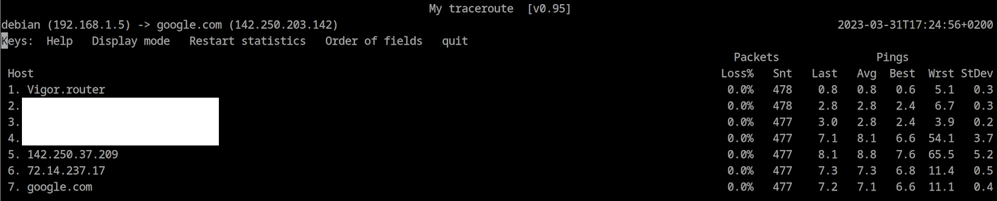

      Look how my old draytek 2110 router is running.
      On r7800, when it gives a ping at an interval of 0.5 seconds to the router itself, it's ok, but when I give further, the stairs begin.
      With an interval of 1 second, netgear is ok, and from 0.8 seconds and less, the problem begins.
