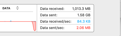

Strangly connecting to my local Qnap NAS over wifi only gets consistant read/writes at less than 2MB/s:

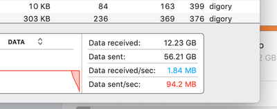

whereas over wired it goes at 95-100MB/s - which I would expect:

      I am however dissapointed in the speeds I'm getting connecting to my Qnap NAS over wifi. The NAS is a Qnap TS-431P and the Ethernet port it uses is a Annapurna Gigabit Ethernet adapter. I do understand that reading/writing large amounts of data over wifi is not optimal - but the speeds I'm getting are slower than some basic internet packages.
      I feel the bottle-neck in speeds reading and writing to my NAS is the router. I used the BlackMagic Disk Speed test to find out sustained read/write to my network drives over ethernet and over wifi.
      The test showed over Wifi the read/write speeds to my NAS were sustained 1-2.5MB/s. Whereas over ethernet I am getting sustained speeds of 95-110MB/s.
