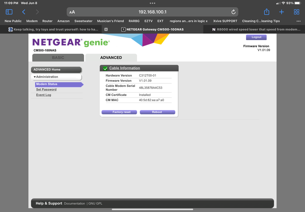

      • pjd813's avatar
        pjd813
        Guide
        Hi,
        I thought that I pasted a copy of the modem status page below. If that's not it can you let me know which screen I need to send? Maybe a picture example of the right page?
