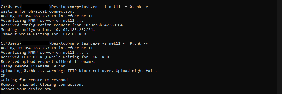

14.  If all turned out fine you should see this on the output of nmrpflash
I had to run it atleast 3 times to get the timing right. I would reccomend for to wait atleast 3 minuites before rebooting.
After waiting I got this
You know it failed if nmrpflash timesout after 60s without Receiving Configuration.  You will also know that it failed if the 3 WIFI leds turn on solid white.  You have turn off the router and start at step 10.

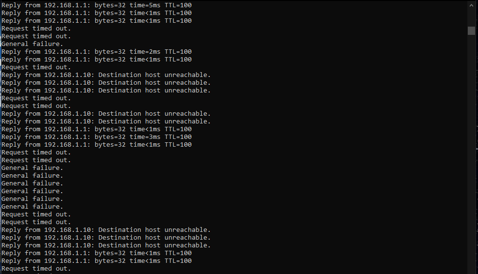

If you still have trouble getting the timing right look at the ping cmd window and see what is happening while doing steps 11 and 12.  You might have to hold it for longer or less
Here are my failures:

    HOLY SMOKES!!!!!!!!!!! THIS ACTUALLY WORKS!!!
    For me, the timings were completely different than what you said.
    Here are the steps that I took that worked for me:
    • Turn off the router
    • Execute the code "nmrpflash.exe -i PORT -f .0.chk"
    • Turn on the Router
    • Once the Orange light comes on, press the Reset button
    • The upload should do its thing.

  • Man I still can'get this to take.  Any ideas...mine just keeps saying destination host unreachable.
    • michaelkenward's avatar
      michaelkenward
      Which command did you issue when you got that response?
      • tlreese77's avatar
        tlreese77
        Sorry thats on the Ping command.  I can get the other stuff to almost work, but it seems to always timeout, probably just a timing issue on my end.
