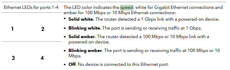

    When two devices with Ethernet adapters are connected with an Ethernet cable, the electronics built into the physical adaptors negotiate the highest speed that can be supported.  When the link is negotiated as 100mbps, then it is physically impossible to transmit any higher speed than "mid 90's".
    Page 12 of the User Manual describes how the Ethernet LAN ports indicate the connection:
    Unfortunately, it does not appear that the WAN port has a similar capability.
