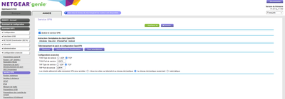

Hello,
I have a Nighthawk R7000 rooter with a default OS (which I can't change).
I have for several years activated the vpn service with open vpn which works very well.
However, I'd like to increase security to connect to my rooter (and therefore to the connected nas server): set up a login and password connection.
Is there a (simple) solution for this type of connection via open vpn?
Is it possible to give rights to certain identifiers or remove them?
I'd like to stop distributing the identification key, but to grant connection rights.
Thank you in advance for your reply.

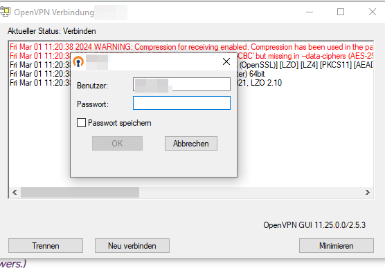

    Here a very old OpenVPN Client Syno config example (no guarantee):
    dev tun
    tls-client
    remote XXXXXXXX.synology.me 1194
    # The "float" tells OpenVPN to accept authenticated packets from any address,
    # not only the address which was specified in the --remote option.
    # This is useful when you are connecting to a peer which holds a dynamic address
    # such as a dial-in user or DHCP client.
    # (Please refer to the manual of OpenVPN for more information.)
    #float
    # If redirect-gateway is enabled, the client will redirect it's
    # default network gateway through the VPN.
    # It means the VPN connection will firstly connect to the VPN Server
    # and then to the internet.
    #redirect-gateway def1
    # dhcp-option DNS: To set primary domain name server address.
    # Repeat this option to set secondary DNS server addresses.
    #dhcp-option DNS DNS_IP_ADDRESS
    pull
    # If you want to connect by Server's IPv6 address, you should use
    # "proto udp6" in UDP mode or "proto tcp6-client" in TCP mode
    proto udp
    script-security 2
    comp-lzo
    reneg-sec 0
    cipher BF-CBC
    auth SHA1
    auth-user-pass
    <ca>
    -----BEGIN CERTIFICATE-----
    MIIDTTCCAragAwIBAgIJAOQ2welR+cy6MA0GCSqGSIb3DQEBCwUAMIGnMQswCQYD
    xxx
    -----END CERTIFICATE-----
    </ca>
    Bonne chance!
