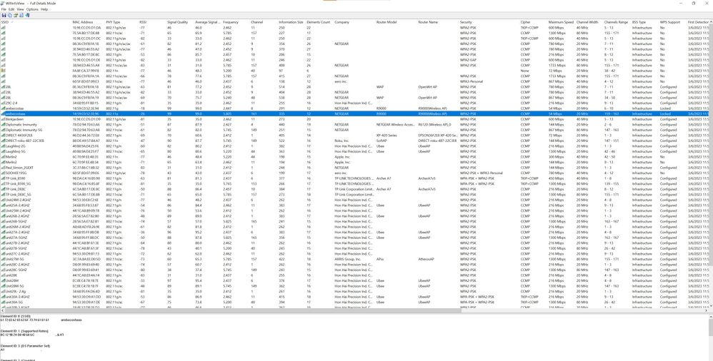

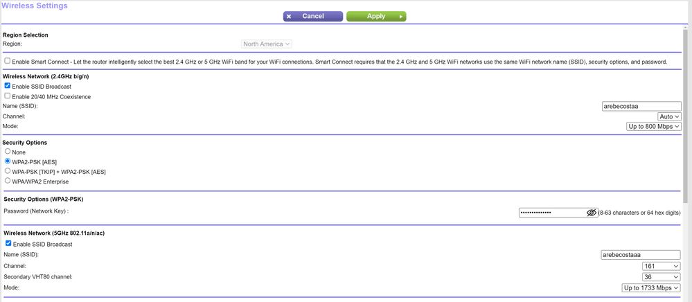

      Here are snapshot of my R9000 settings and wifi scan by WifiInfo
        I cannot see any image file you insert until approved by moderators.  Much more efficient to attach image files.  See attached.  Limit to one attachment to reply.  Just create more than one reply.
