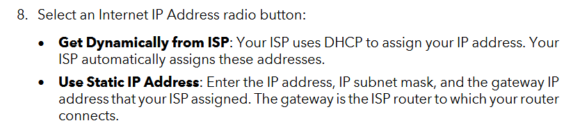

      CrimpOn wrote:
      Yes, defining a Static IP address for the router WAN port is a feature of the RS100
      Not sure that answers the question.  But you can disable NAT filtering in the router, so I think you can set up public IP address subnet on the LAN.
