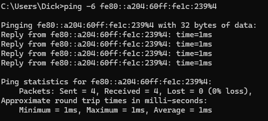

    The Windows command ipconfig /all will show information about the network interfaces.  My computer, for example shows this:
    If I do ICMP with IPv6, I get this:
    If you try that on a computer connected to the RS300 what happens?
