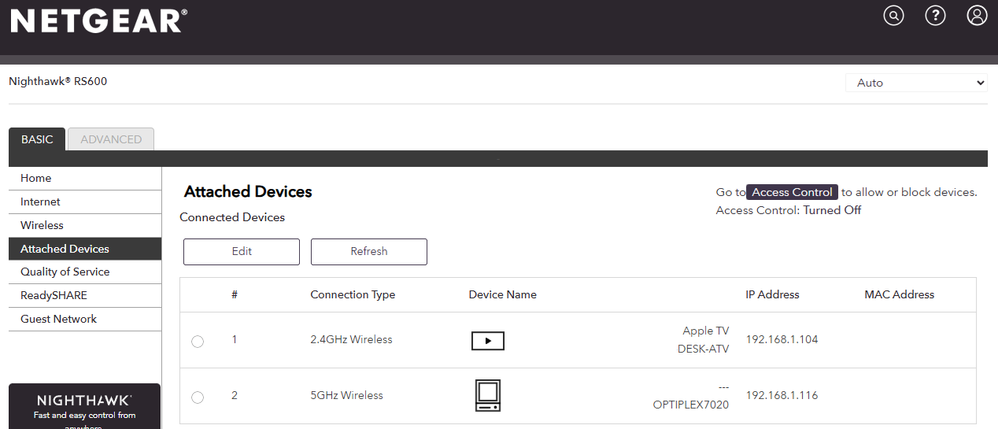

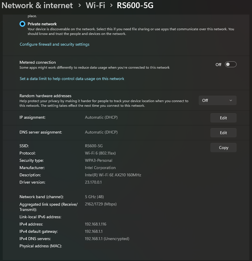

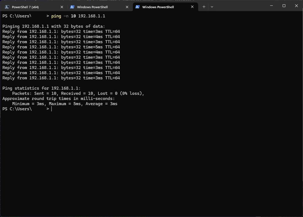

    Just tested my RS600 here and getting same thing on a AX210 adapter PC on 5Ghz:
    I had to disable Smart Connect to force my adapter to 5Ghz as it kept connecting at 6Ghz. I didn't test 6Ghz.
    I'll pass this to NG and see if this is something acceptable and if there is any suggestions or information. May need some tuning in FW.
