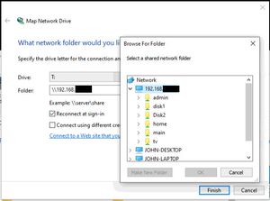

I am trying to map a new drive in put into my Ready NAS 314 4 bay system. I had a drive i call disk1 which I am able to map but for some reason I can't get the new drive which I am calling Disk3 to ...

How did you add the drive? If you added it with XRAID on, it would not form a separate volume. It would either add redundancy to your original drive if it's the 2nd drive inserted or it would expand the volume if it was the 3rd or 4th.
If you did add it as a separate volume in FlexRAID, you normally map shares, not drives, so you have to put a share on that volume.

It is not set up as an X-RAID. I am pretty sure it is set up the same way as my disk1.
- Zmaster211Mar 12, 2021Aspirant
This is what my volume screen looks like.

Have you created any shares on Disk3?
If you are running windows, what happens if you run CMD and enter this?
net use * /delete /y net use t: \\nas-ip-address\Disk3 /user:admin nas-admin-password
Use the real NAS ip address and admin password of course, and be careful with the two different slash directions.
The first command will terminate any network connections (and it will unmap your other drives). If you are already using NAS admin credentials to map your other drives you can try skipping it.
The second attempts to mount disk3 as drive letter t.
