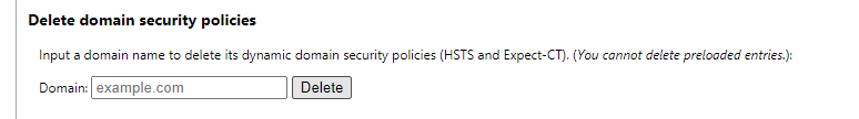

We've tried clearing HTST from the chrome browser entering the Domain to clear the policys

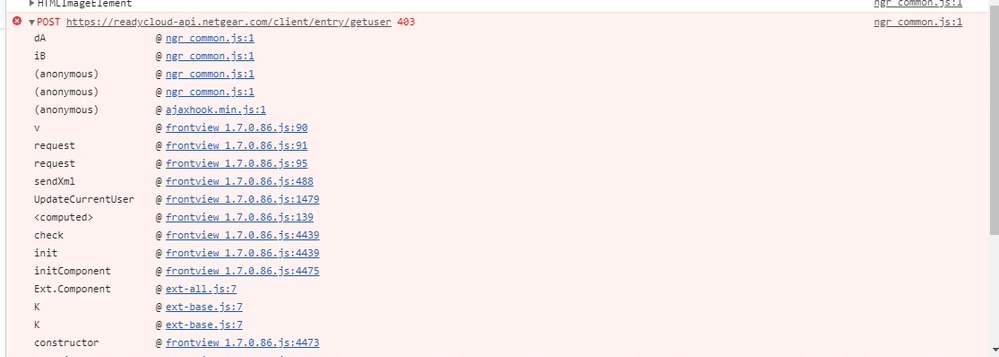

From our testing we also saw a 403 error on the console log
