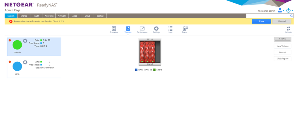

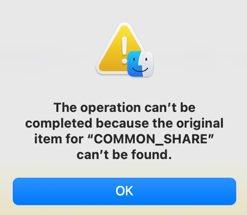

I have been using RN214 from past 4 years. It has been working perfectly. Suddnely this morning we faced an immediate powerloss and after than when the RN214 started, we have been getting this error. We are not being able to access any of the partitions that we have made inside. I have also attached the error that we get while accessing the partition.
What posibly we can do with this. Our all the data is in this and technically the whole office is stopped due to this. I can see that the existing 5.44TB data is still in there, and I need to know what can be done to make sure that the drive is in up and running condition.

  • A technical support from third party told me that actually a last slot is open and installing a new drive in it going to solve a problem instantly as the storage is full. I doubt this as a week back i had deleted 2 TB of data. Also he said that reinstalling the OS will solve the issues. What are your views??

      patelshivrajs​ said: A technical support from third party told me that actually a last slot is open and installing a new drive in it going to solve a problem instantly as the storage is full. I doubt this as a week back i had deleted 2 TB of data. Also he said that reinstalling the OS will solve the issues. What are your views??
      Bad advice.  The size in your screenshot is the max size (capacity) of your RAID-5 volume.  It does not tell you how much data or free space is available on the volume.  The "inactive status" means that an error is preventing the volume from being mounted.
      It looks like you have one failed disk (the one that is empty).  It's possible that a second one has also failed - in which case you are likely going to need RAID recovery to get your data (and that might not work).
      It is also possible that we can forcibly remount the volume.  That requires use of tech support mode (and the linux command line).  There is risk there, particularly if you have never used the linux CLI.  So even if that is possible, you still might want to use RAID recovery.

    There are several things that can cause this problem - some can be easily repaired, others cannot be.  It looks like your volume should be 4x2TB RAID-5 (that would have a ~5.44 TiB volume size) - but I am only seeing 3 disks in your screenshot.  Should there be 4 disks?

      Hi Stephen! You are right. It is 4x2TB, this is what the quotation from my purchase says. But you rightly pointed out that the screenshot says only 3. There should be 4 disks.
