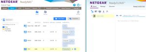

Shares/Volumes not detected on ReadyCloud since upgrading firmware
I am running a ReadyNAS 102 which is connected to ReadyCloud. While running firmware 6.5.2, I could see my shares on the home tab. However, since upgrading to 6.7.4, the NAS is still detected but...

Just an update for completeness, I have now tried the following, without success in getting shares/volumes to appear in ReadyCloud:
- Deleting the volume and creating a new one in the new firmware (the NAS is being rebuilt anyway, so it was trivial to try it).
- Swapping the drive to Bay 1
- Putting another hard drive in Bay 2 (ie, no empty bays)
- Adding the second hard drive as another JBOD volume (ie, all disks part of the active system)
- Adding test shares to both drives (all disks have shares)
- Adding test data to both drives (all disks have data files)
- Deleting the JBOD volume and making both drives a RAID 0 volume
- Deleting the RAID 0 volume and making both drives a RAID 1 volume
At this point, unless anyone has any suggestions, I think I will need to try rolling back to 6.5.2.

Second update. I solved my problem with, basically, a downgrade and upgrade of the firmware (details here), but it was fairly risky, and I would not recommend it as a fix. I only tried it because I didn't have any data at stake and I was willing to risk the hardware. My shares are now showing up in ReadyCloud from my reinstalled 6.7.4 firmware, so it's quite likely that a factory reset on its own would have gotten me there. That would be my suggestion to anyone else with the same problem.
I don't know if there's any etiquette issues of marking your own post as a solution here (not sure if there are karma points etc involved?) but I'm going to mark it solved so future people searching can see what didn't work, and what did.
