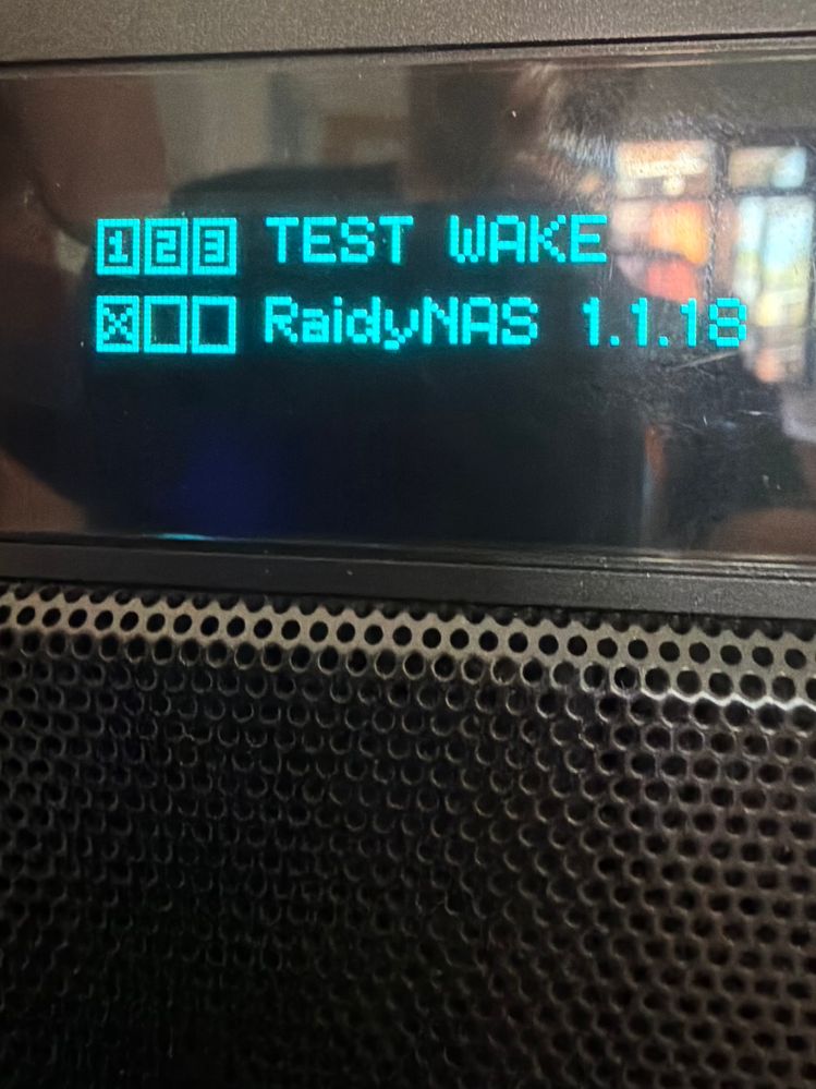

Pro6 support is done. Fan control, LCD display, backup button used for LCD wake after dim. Disks have hotplug monitoring in/out, and automatic and guided disk set rebuilds are done.
RN516 testing underway.

516 support is done. Fan control, LCD display, LCD wake triggered by any button press. Need to re-test the RAID operations from Pro6, and regression test that adding 516 support hasn't broken anything on the Pro6.

So far on the 516, I've not found a use for the buttons on the front. They are only used to wake the display from dim/sleep. I've already got a rotating RaidyNAS display showing IP, errors, root % used, zfs % used. Didn't bother with temperatures for now. I guess it could be a configurable list.... On the ReadyNAS OS, the buttons are used to navigate through a series of data points, but my approach is to cycle them on the display anyway.

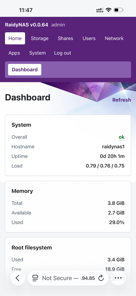

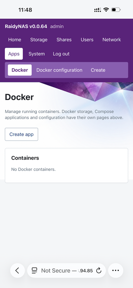

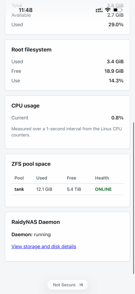

First generation web UI done

Note change of direction. I’m not going to use OMV anymore. Have implemented what I need in my own UI.
working through the features and services one by one.
at some point I will need to merge the RaidyNAS daemon project (which manages disk state, rebuilds, fans, lcd, buttons) and the ui project.
