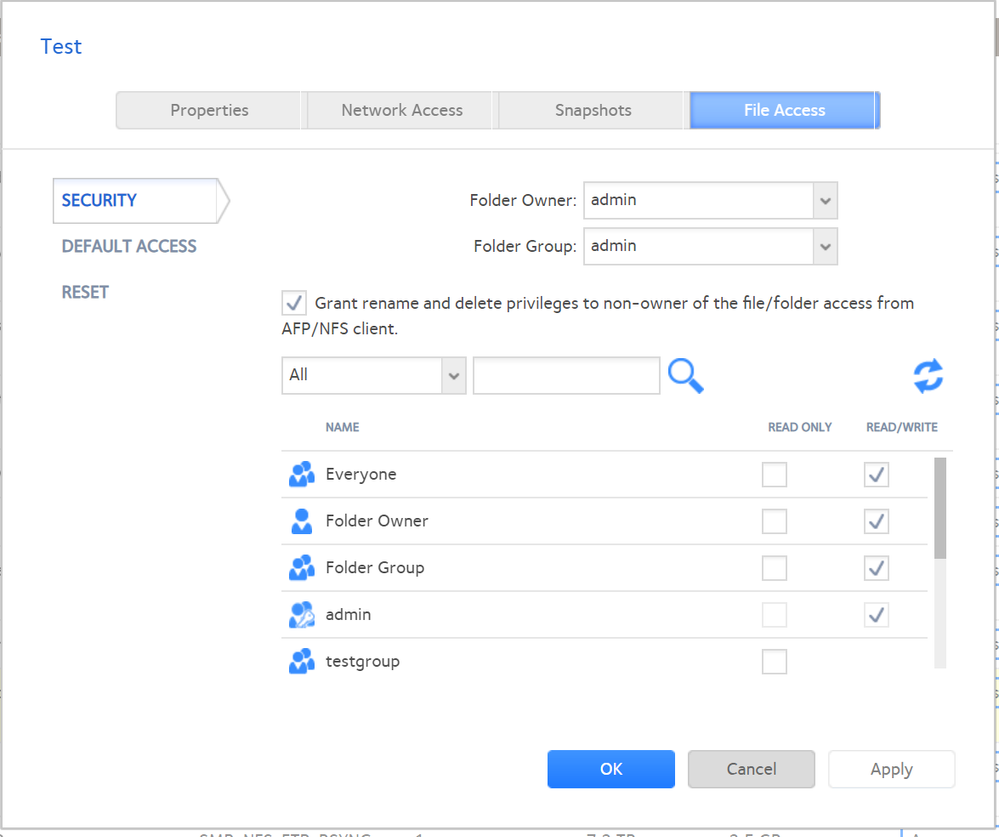

        The "popup" screen they don't show in the article looks like this:
        You can of course use any user/group you wish.  I do recommend enabling everyone access, and checking the "Grant rename..." box.  OS-6 separates Network Access from File Access (a bit different from the Duo).  It's simplest to manage access using only the network access settings, and leave file access set to full access.
        The RESET control on the left will reset the permissions recursively, so everything will be changed.
