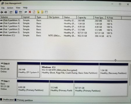

I have a sata to usb attachment which connects the drives and they show up in 'disk management' with 3 partitions but each one shows that it has 927gb of free space. (image below, disk 1 being the drive from the NAS)
No, that is not free space. Windows is showing all the partitions as "free space" because it does not recognize the file format.
- Partition 1 is the OS partition (linux and the NAS application)
- Partition 2 is for swap
- Partition 3 is your data volume
Royalblue wrote:
Is there any way I can read the files on each of the drives and transfer them to a windows laptop?
If you know linux (I'm guessing not), then you can boot up the PC under linux and manually mount the volume.
Another option (which costs) is to purchase RAID recovery software that supports the BTRFS file system. ReclaiMe is an option that several folks here have used with success.
Either way you will need a way to connect all the disks.
