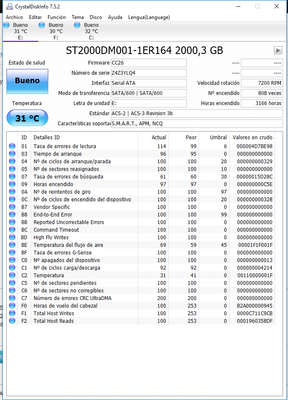

It´s been a couple of days since I´ve been setting it up but there is nothing else I can do. I have tried a couple of possible solutions but nothing worked so I am going to tell what I have done and see if you can help me.  am using the hard drive I used for local network, and I just want to let you know that I only store movies on it so I don’t use it that much and it has got more or less a year since I bought it.
So, I formatted the hard drive which is a Seagate ST2000DM001 and inserted in the chamber 1 of the NAS. After turning it up it did nothing, I wasn´t able to find it in the Ready Cloud web page, also pressed the backup button for 5 sec. and nothing. I also downloaded the RAIDar programme and still the same.

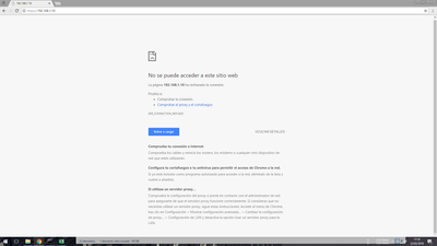

I can ping the ip from my PC sending 4 packages and receiving them too, I have also tried looking up they IP through the browser and nothing. So, I thought it would be a problem with the hard disk so I decided to formatted using this manual selection Factory default and leave it "think” for 30 min; useless.Right now, it has the power button blue and the rest are off. I´m also going to post some photos as they may be useful.

      Disconnect eth1 for now, and just use the one ethernet connection.  If you want to use two, you need to configure NIC teaming in the NAS - let's wait on that until you get everything else up and running.
      Then try entering http://192.168.1.10/admin into your PC browser, and see if you can log into the NAS.  There likely will be some security warnings that you need to click through.  When you get to the login screen, enter admin for the username and password for the password.

        Hi, I have tried what you told me and nothing, the webpage refused the connection with error: ERR_CONNECTION_REFUSED so I restarted the router just in case. Still the same I start to think that the hard disk I´m using could be the problem, is there any way I can make sure it´s because of this? Do you know how the lights are supposed to be turned on if the disk is not recognised? And can it boot up without any drives and show an error that there are no drives connected?
         I was thinking of buying a proper hard drive for the NAS but 1st wanted to test it and don’t really want to spend 200 euros on a 6tbif it is not going to work as I cannot determine if the NAS if failing or the drives.
