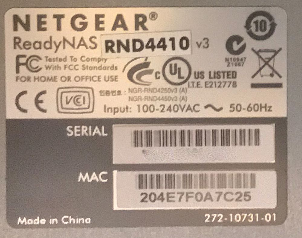

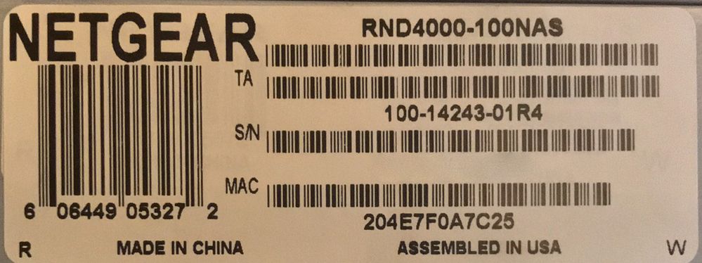

I have a very old (8 years?) ReadyNAS NV+ that just died (no power whatsoever). Model description included in the pictures below.  Clearly I need to recover the data, looking for the most cost effective solution.  I don't intend to stay with a NAS solution as I can put everything on a much faster 6TB USB 3.0 drive significantly cheaper (even buying 2x for backup), so I just need a way to read off the contents. I tried contacting Netgear but all my registration data for this unit is missing (I replaced the chassis under warranty early in it's life so I know it was registered at some point) but given it's age I doubt there's anything they'll do for me.  I found somesimilar diskless units online, thought I might buy one of those and throw in the old drives.  Just can't be sure how compatible these units are (example).  Also hate to pay that kind of money for a one-time data recovery if there's a cheaper option...
