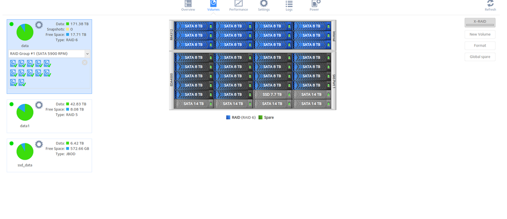

We have a ReadyNAS 4312S with EDA 4000 Expansion chassis. It has 36 slots populated (12 slots in 4312S + 24 disks in Expansion Chassis).
30 * 8TB Disks in RAID6 - /data volume
5 * 14TB Disks in RAID5 - /data1 volume
1 * 7.68TB SSD in RAID0 - /ssd_data volume

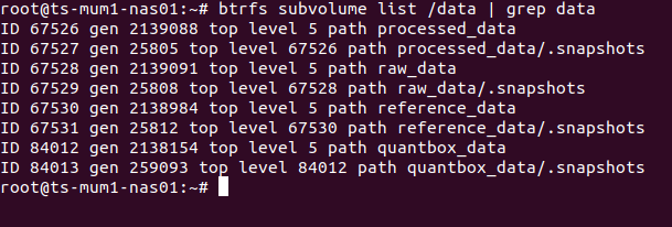

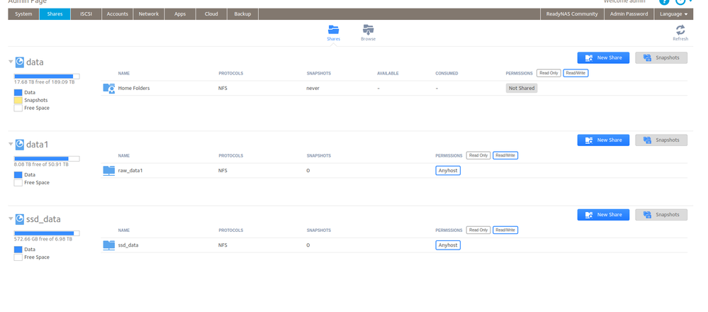

Few days back we rebooted the NAS and the volumes didn't come back online automatically. After another reboot, /data1 and /ssd_data came online but /data was showing down. After a lot of digging around, I finally was able to mount it manually and it worked.
But in the GUI, the shares related to /data volume isn't showing up (screenshot attached for Reference). Any thoughts on how to fix this? (any particular service that can be restarted to fix this issue?)

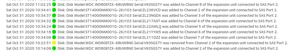

And to expand the volume, we added an expansion chassis using the second SAS port. We populated 7 disks in the expansion chassis. The disks are detected in the logs but the expansion chassis is not showing up in the GUI.
Due to this. we cannot provision the volume? I did look around but didn't know how to fix it. Any pointers on how it can be fixed?

There is a script that can be run via SSH that's for this type of issue, but I've not looked at it to see if it'll work right with the EDA attached. So, it is best to wait for one of the Netgear mods to respond and verify it will.

The script that repairs the share configuration is here: https://gitlab.codycook.us/readynas-scripts/share_lun_ui_fix.sh
But I agree with Sandshark that it would be best to get some guidance from Marc_V or JohnCM_S before you run it. Another option is to contact Netgear paid support via my.netgear.com.

- In the NAS, 'ls /data/._share --all' shows up the volumes in CLI and everything is working as expected, its just that volumes don't show up in the GUI. Will running this script fix that issue? (and not break anything else?)
- The NAS is on ReadyOS 6.9.3 but I believe the script expects v6.10.0 or higher. Is it stll safe to run the script?
Thanks once again for your help.
- StephenBGuru - Experienced User
I haven't seen any cases here where the script has broken anything. I don't know if the script will fix your issue though.
euhr wrote:- The NAS is on ReadyOS 6.9.3 but I believe the script expects v6.10.0 or higher. Is it stll safe to run the script?
The documentation does say that it might not work on 6.9.x or older. Sandshark might have run on on 6.9.x, hopefully he will chime in.
- SandsharkSensei
I have not actually run it. I mostly studied it to learn the structure of the ._shares folder. I did run just an extracted portion that identified the shares to verify it found everything on the expansion unit, but not the rest. I run OS 6.9.6 (current long term support version, to which you really should update after you get this fixed) and see nothing in the script that looks to be incompatible. But I also don't use ISCSI, which the script also fixes, so don't know if there is anything different in 6.10.x in that area.
Given this is a production NAS, you may want to consider using Netgear Support instead of going in and fixing it yourself. Even if you have a backup, that's a lot of data to restore if something gets more messed up and you have to factory default.
