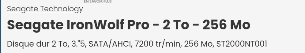

Hello, I just bought a new HDD ( ST2000NT001 - Seagate IronWolf 2 TB) but when I insert it in my readynas 102 it is not detected.
    Did you mean 20 TB?  Or did you type the wrong disk model?
    FWIW, I have see a few posts here from folks using 18 TB drives in their RN102 NAS, but I haven't seen anything bigger.

      No, I really meant 2 TB and I took the reference on the shop where I bought the disk.
        My bad, I mentally added a 0 to your model number (ST20000NT001).   So the size certainly is not the issue.
        I suggest using Seatools to check it.
        It's available for both Windows and Linux platforms.
