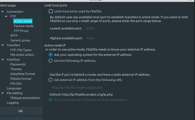

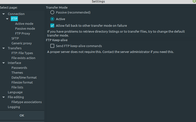

I am trying to connect to my ReadyNAS Duo v1 with filezilla, see the attached screen shots. I am using the admin log in and password. It appears to be connecting ok but will not get a directory listing.

    corkscrew22 wrote:
    here are the ftp settings in screenshots below
    This one needs to be set to passive, not active.

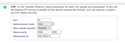

        Looking more closely, the passive port command appears to be on IP 192.168.2.3, but the control connection appears to be on 192.168.2.9. That suggests that masquerading isn't set up correctly on the Duo.
        corkscrew22:  If you have masquerading set on the Duo's FTP settings, disable it.  Some clients need it, but FileZilla isn't one of them.

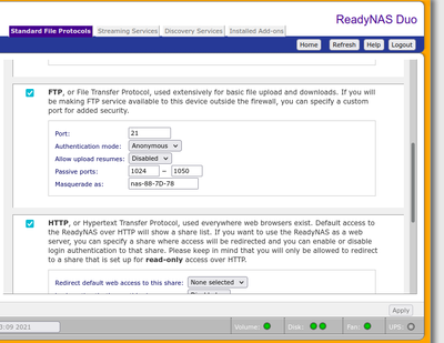

      as for Masquerade settings I had it set to the below first
      This did not work and as mentioned it is not required so i set back to the default see below
      So i then try to connect using these settings

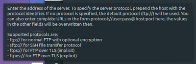

      Host ftp://192.168.2.9, username and password i leave blank , Port i put 21, the result is pretty much the same as before from what i can see it connects but cannot retrieve a directory listing.
