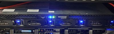

firmware updated a RN2120 stopped communicating with it
Hi
Just manually run a firmware update on a RN2120 said it was successful rebooted, now I cannot ping it or contact it. I have rebooted and powered it off and back on again still nothing.
The rn2120 would not update from its webpage either, I did the manual firmware upgrade.
The picture below shows all drive lights on power light is on and has network activity and the ethernet port on the back has normal activity. Anyone have any ideas maybe roll back the firmware ?

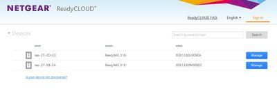

      I have tried using the RAIDar software did not find it.  If I use ReadyCloud to discover picks up 2 NAS 316 but will not find the 2120v2
