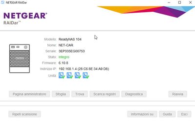

Does RAIDar find the NAS?
done and this is what I see
You'll likely need to also install the Java JRE
done even if I am not sure they are up to date.
carlocki wrote:done everything you said.
Did you use a static address that is compatible with your home network?
yes it works

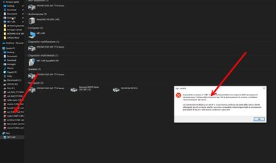

here the main issue

- carlockiJan 09, 2024Luminary
this
x-raid confirmed
I cannout mount t:nas entire
with the right code
now is working with
+user/realpassword
1. after a restar I had to remount everything.
but the system now accepts the password and the new user
2. second restar I lost also credentials again
- StephenBJan 09, 2024Guru - Experienced User
carlocki wrote:
now is working with
+user/realpassword
As I originally said, you need to use the real admin password instead of the placeholder (nas-admin-password) I used.
Also, you cannot use \\192.168.1.4\net-car, because net-car is not a share (and also not the volume name).
So the fact that everything worked tells me that there is nothing wrong with the NAS setup, and therefore no need to do a factory default.
I believe the issue is simply that you aren't using the correct credentials when accessing the NAS from the PC.
You can only map the full data volume with the NAS admin credentials. So if you want to do the test with Windows CMD again with the new username, you need to use \\192.168.1.4\sharename Again, sharename is a placeholder - you need to use a real sharename on your NAS.
If that works, then try the same test again, using \\net-car\sharename This will confirm that you can access the NAS using both its hostname and its ip address.
