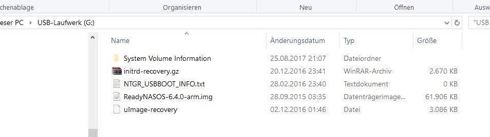

As next, I've started the boot menue and selected "OS Reinstall". No help. So I tried to create the recovery USB-Stick by using https://kb.netgear.com/app/answers/detail/a_id/29952
The KB was not really working for me, because the tool never created a "marvell" folder for my case. So I created the usb-stik by my-self :
(see attached file) and started USB-recovery mode.
USB recovery seemed to be successful, because the device is able to boot again and finishes with the errors message (can't find any dis-drives). Of course, I ejected all 3 4TB disk-drives before I started any recovery tries.

  • Hi again,
    fixed it! Finally it worked for me! Got my unit to work again after many different FW version flash tries. At the end I've used this USB stick:
    and VERY IMPORTANT do not eject/remove your original disks from the system. The FW upgrade can not start, when the org disks are pluged into the system.
    No strange marvell - folder is required. 6.4.0 is much faster than before and many usefull options are included now.

        Could someone tell me, if my usb Recovery stick was created correctly. Always when i tried to use the Automated usb creation tool, that specific marvell folder was missing...and i never could select a img file within the tool
        ... someone knows a working guide, how to create a recovery usb stick with any fw version for rn104 device succesfully?
