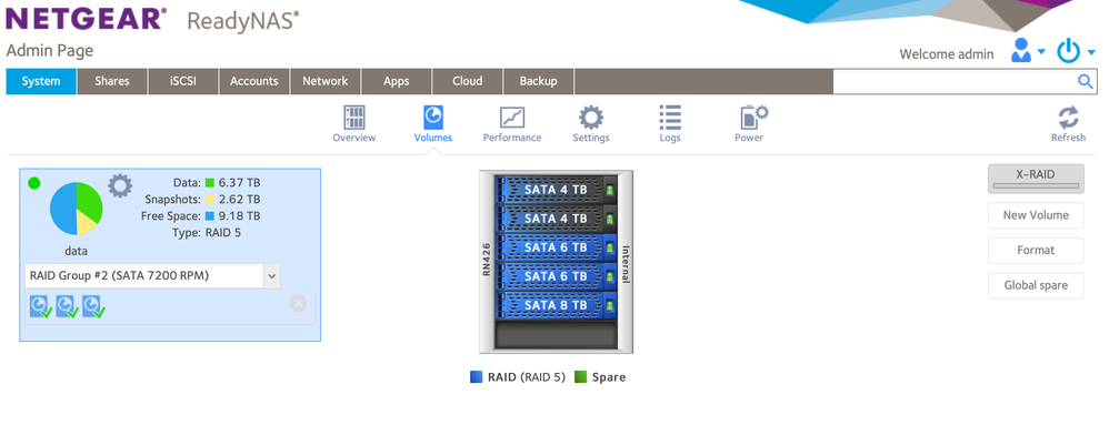

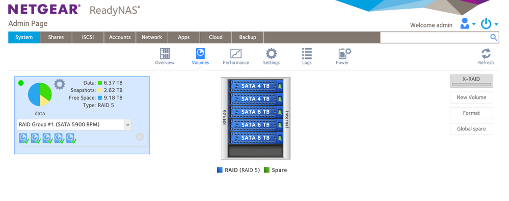

I have 2 volume groups showing, after adding a disk- is something wrong?
Sorry - this will be a long post to explain what I am seeing. I want to know what I should do about this situation to best protect my data.
I have an RN426, and I had 2x 4TB and 2x 6TB drives configured as XRAID2. I had a single data volume which has 6.37TB of data and 2.62TB of snapshots on it. I have backups of some data, other data (about 4TB) is not backed up as yet. All had been stable and no issues for over 2 years.
I bought and added a 1x 8TB drive into the array (the plan being to upgrade to 6x 8TB drives slowly using XRAID2). However after doing so, once the drive had been accepted and the volume expanded, I noticed something rather odd.
It appears that the unit has dropped out of XRAID2 into Flex-RAID, and I now have 2x volume groups.  I still see a single /data volume and can access ALL my data without any issues, and the unit appears stable. I have sat on this for a month, wondering if it would revert, there has even been a firmware upgrade recently but that didn't help.
The latest firmware is on board and the drives are all IronWolf Seagate Drives.
So I see 1x volume group  which shows all 5x drives in it, and lists them as 5900rpm, which is not true of the 8TB drive. I can then see a second volume group which has the 2x 6TB and 1x 8TB drives in it, listed as 7200rpm drives.
Does anyone know what I should do to get back to XRAID2?  I have a further 8TB drive I want to add into the array, but with it currently being in FlexRAID I don't know whether to add it or not just now.
Is this a bug, a sign of impending doom, and what should I do about it?

  • Sorry tried to add screenshot photos but all I see is a triangle ! I'll add them as files ...

      and the 2nd...
