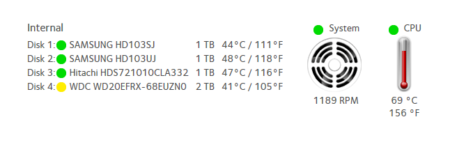

Well, with a 120mm fan on the front and an 80mm on the rear:-
Which is really where it should be. I suppose that the one thing about the WD Red drives is that they do run a lot cooler and a bunch of hot drives don't help, especially when they're 3.5" ones and will subsequently restrict airflow but this should really be accounted for.

I've come back to this thread as I continue my journey with my new unit.
I've now populated it with 4 x 2TB WD NAS drives which run cooler than the others I had in there. My CPU temp is between 75 to 76 degrees without running my extra fan stuck to the back of it.
I know that firmware 6.5 has some fan control but my question is, what should we expect to see on these units with these drives? 4 x 3.5" drives are going to restrict airflow but this CPU temperature is too high in my view, regardless of whether it's at the alarm point or not. I did read that someone else with 76 degrees was sent a replacement unit so i'm a little concerned about the longevity.
I've submitted the same question to support as i'd have expected this to be a tested and known value and if they ask me to try the 6.5 firmware i'll do that and see where it goes.
