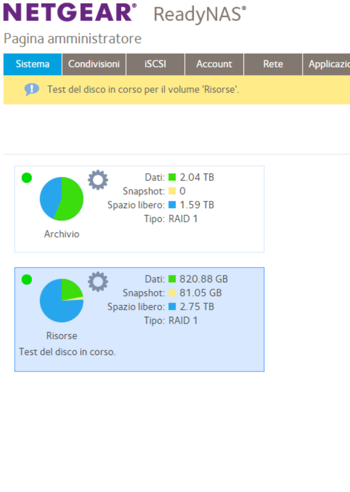

need to solve hdd failure on a Nas RN104
my 4x 4 tb rn104 nas is having problems

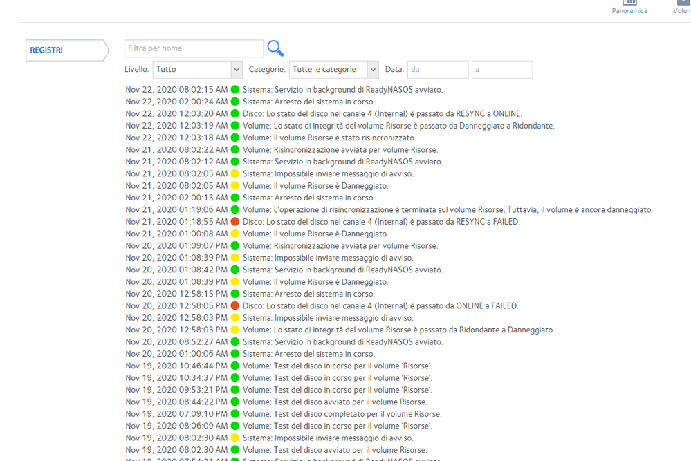

a couple of days ago mechanical noise and after 20 hours or recovery a second failure and again 20 hours of recover this is the report
then the second failure i want to change what i thing is broken (i think 4th 4tb hdd)
this is the situation
Also which cloud service to fast backup all or it is better to have an external hdd just for a first backup
right now i have no bckp.
I can access the nas right now

        It looks like the resync failed on disk 4 (per the first screenshot).  The second one says a disk test is in progress, it's not clear what the timing is.  However, it looks like disk 4 might have failed.  The best way to confirm would be to power down the NAS, and connect the disk to a Windows PC, and test it with SeaTools.  You can connect with a USB adapter/dock if you can't connect it with SATA.
