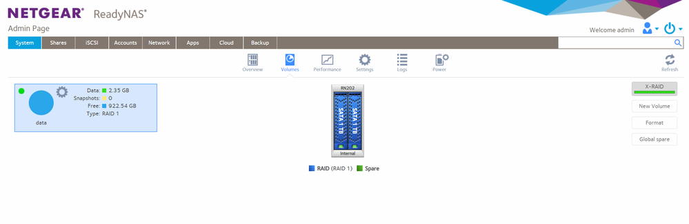

      • StephenB's avatar
        StephenB
        humadon1 wrote:
        When I go to System - volumes (see attached screenshot) I only see one drive.
        Your screenshot isn't showing the volume page.  You need to log into the NAS admin UI (for instance by clicking on "admin" in RAIDar, or by browsing to https://10.1.10.252/admin
        The volume page looks like this:
        So log into the admin web ui and look at that page (selecting "system" in the top row, and "volume" in the second row).
        But I think Sandshark is already pointing you in the right direction - and that what you are seeing is normal behavior.
        First of all, there is a difference between a volume and a disk.  With RAID, a volume usually is built from more than one disk. When you look at the volume page, I'm pretty sure you will see a screen shot similar to the one I posted above (except yours will show two 4 TB drives).
        That is, you'll also see a single RAID-1 volume called "data".  That volume is built from both your disks.
        You'll notice that in my screenshot the capacity of the volume is 1 TB, even though the total of the disks is 2 TB.  That is a result of RAID-1.  The two disks are mirrored (everything written to one is written to the other).  That protects my data if one disk fails.
        First let's confirm that you are seeing a 4 TB RAID-1 volume on that page.  Then we can talk through whether that is the right mode for you, and what options you have if it isn't the right mode.
