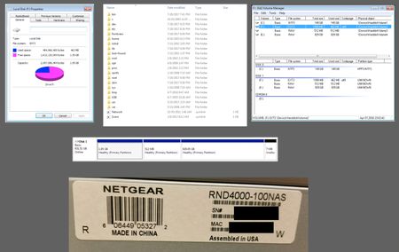

Problem: Was trying to access NAS (Raid 1 setup), drive went away from windows explorer. Manualy rebooted NAS, NAS won't start. The PSU went bad. Since this NAS is very old I'ld like to upgrade and m...

You should be looking at E (the 1 TB volume). Your screen shot is of the OS partition. The "C" folder there is a placeholder (the NAS mounts the data volume to that mount point).

Thnak you very much for replying StephenB! I have a quesiton reguarding why look in E: (RAW) vs F: (EXT3), if the data that has all my files are on E: what is F: for? F: has a ton of empty folders, why is that?
You'll notice that F is only 2 GB in size. It's the OS partition that the NAS boots from. As I explained with C, many of the folders there are placeholders for mount points from other places (for instance the data volume).

Try using the other disk drive, and see if E is also shown as RAW there. It might well show up as EXT. And try r-linux for windows.
