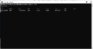

Hello
I bought a broken ReadyNas Ultra 6.
I managed to start the NAS. Its flash memory is damaged and impossible to flash it because no access to the USB Boot.

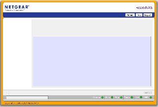

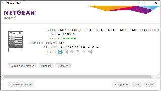

In windows it is recognized by a weird name and Frontview does not work to configure it.
Since I have another identical NAS (which belongs to a friend), I configured the hard drive and then put it back in the other. I thus have access to the shares created via the file explorer.
I tried in the Boot Menu the options "Factory Reset" and "OS reinstall" but without result.
USB Boot is not working. The key lights up then flashes directly twice. Then nothing: the LCD screen remains on ReadyNAs. The key is good since it works on the other NAS.
I have access to Telnet via the boot menu. It might be possible to fix flash memory through this but I don't know anything about it.
So it is usable but only by configuring the hard disks on another NAS.
Is it possible to repair the flash memory (without access to Front View or USB Boot)?
If not, is it possible to configure it (creation of volumes, shares, users, etc.) without going through Frontview?
Thank you in advance for your help.

    Only seeing one of your screenshots my guess is corrupt EEPROM.

        From Capturenetgear2a.jpg it's clear that the EEPROM is corrupt, so USB Boot Recovery wouldn't fix the problem. It may help if other files on the internal flash are corrupt, but it won't fix the EEPROM issue, so the NAS won't boot up fully and the OS won't know which model it's running on.
