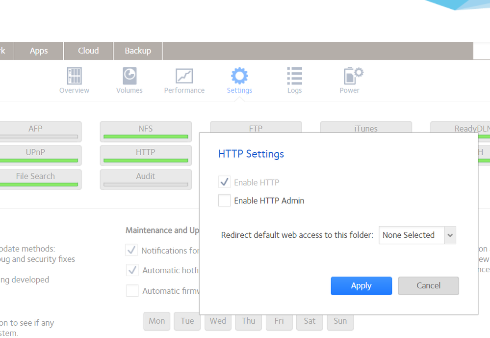

      Ric_CT wrote:
       ... given that there is no HTTP fallback on the RNAS.
      Actually you can configure an HTTP fallback.
