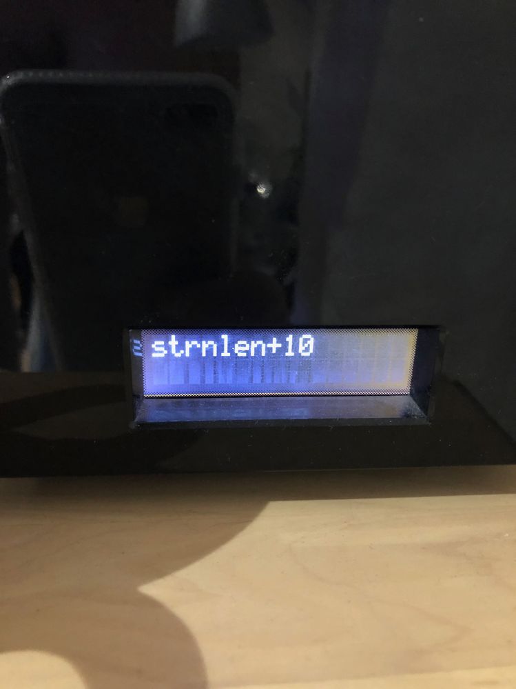

I've had my ReadyNAS 104 for quote a few years now, but have noticed this a while ago that when a change is made to the network adaptor, the unit becomes completly frozen. Waited a few months to see if any patches would cure the problem, but no luck as done the same tonight and now currently re-syncing because the only to gain access to it is to unplug and plug back in.
Any thgouhts?

It's not often I make change to it, but when I do, random number and letters appear on the front display and just hangs
- StephenBGuru - Experienced User
That's a crash location, so something is wrong.
What firmware are you running? Is your NAS still covered by warranty (3 years for the original purchaser)?

Maybe try the 6.9.5 beta ( https://community.netgear.com/t5/ReadyNAS-Beta/ReadyNASOS-6-9-5-RC1/m-p/1656915#M10309 )
It's at release candidate 1, so it should be near production release, and you can revert back to 6.9.4 if you like. It does have several stability fixes for the RN100.
