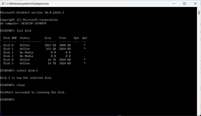

Do they need to be "unformatted" to be used in a ReadyNAS? Found "diskpart" (launched via a CMD window). I selected one of the drives (Drive 5 below) and then "clean" which removed the volume. Now in Windows Disk Management the disk says "Unallocated" and "Not initialized". Is this good enough?

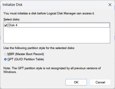

  • On further inspection, appears "clean" (within diskpart) removes the partitioning storage method (MBR or GPT).
    When I right-click on the "Not initialized" area of Disk 5 in Disk Management, "Initialize Disk" shows up and when I select it, I get the box below.
    I guess "Not initialized" might be the correct state for these drives for use in a ReadyNAS, since that's how they appear out of the box... ?
