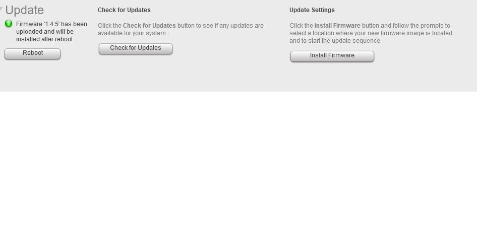

I have RD 5200 without HDD.
I would like to update firmware from 1.4.0 to 1.4.5 , but each time if I download the firmware and Reboot device it start with old version.
Is there any way to update this device?
