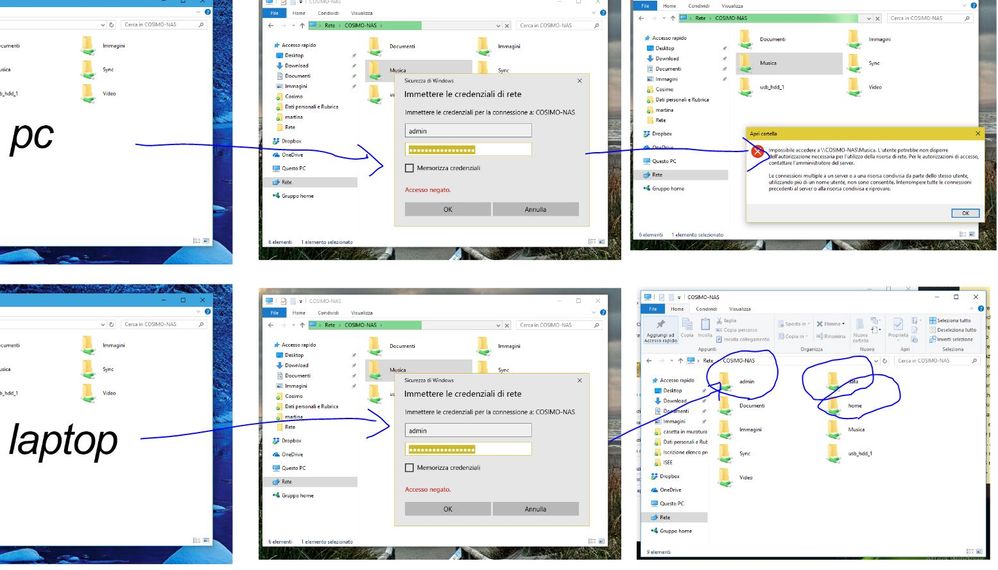

This is what I was tried to do using the account "admin" for my pc. But when I tried to access with this account I got an error!
Now, I tried to create a new account on the NAS and then, after deleted all the credentials, I try to access to the NAS with this new account and again doesn't work.
At this point, since I was not able to set an account on the "PC1" I try to access with my laptop ("PC2").
With the laptop, when I found for the first time the NAS on the network, I was able to saw only the free folder, but then, If I try to go in the restricted folder, windows ask me credential and surprise, on the laptop the account works!!
After I'm able to see all the folder as admin! See screenshot attached.
So, I do not think that the problem is that I'm trying to access to the same device with two different credentials, since this work on my laptop.
I'm writing the credentials just one time, and after I have deleted all from the windows credentials...
The problem should be someone else...

1) run "net use * /delete" > deleted all the windows credentials > restarted the system > result: doesn't work (see attached screenshot).
2) at this point as you say I've added new credential directly into the windows credentials (using as adress of the device the file explorer address "\\COSIMO-NAS" and not the IP) and this time it works! I'm logged as "admin" (see attached screenshot).
So, I still do not understand why the access with password works on the laptop but not on the PC, but, at least, now I know two different ways to make it work. Now I will restrict the access to the other folders only at the admin and at the readycloud user.
