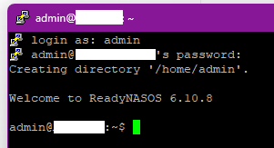

I inherited this device from previous IT guy, so I didn't have SSH turned on.  Now I turned on SSH.  I can logon to SSH with the known webGUI admin password. (Not that I really know what to do in the Linux SSH interface but it's there for emergencies.)  It only fails for RAIDar.  RAIDar only reported that the device status: Healthy.

      Our known-good password worked fine for both WebGUI and SSH. (I don't know enough of Linux to do much without specific instructions.)

      When I removed Disk 3 --- and before it was done rebuilding the RAID --- the WebGUI began working fine.  It has continued working great. Known password is good for both SSH and Web.

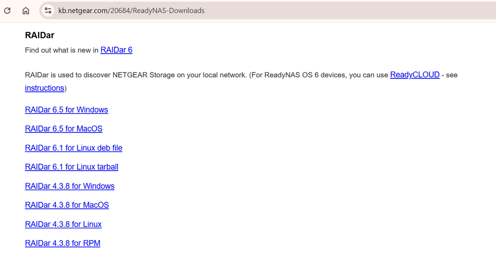

      Aware RAIDar (the discovery utility, this is what it is supposed to be) was updated to v6.1 earlier this year?
      ReadyNAS: RAIDar 6.1
      Most notably, the RN (Last Updated:01/06/2025 | Article ID: 30243!) says:
      It is currently available for download from the ReadyNAS Downloads. RAIDar 6.1 is independent from RAIDar 4.3.8, so users will not receive a request to update.
      Many things are becoming confusion now to me:
      Netgear used to talk (and publish) RAIDar 6.1 years ago, followed by RAIDar 6.5 a long time ago before.
      QA and the team responsible (which dissipated a long time ago unfortunately?) was obviously one more out of the office, Left hand doesn't know what the right hand is doing or what please?
      Screenshot above is taken from https://kb.netgear.com/20684/ReadyNAS-Downloads Last Updated:09/02/2023 | Article ID: 20684
        You can't tell much from the "last updated" field in the KB articles -  that just tells you when the KB article itself was republished.  There's an older version of the article you are looking at here (published Dec 2016):
        No idea what Netgear updated, as the 2016 text looks the same to me as the current article.  The text is outdated, since it refers to ReadyCloud.
        Note there is also this article - "last updated" in 2022:
        As far as the utility goes, you can see the dates if you look inside the deb (Linux) and dmg (MacOS) files with 7-zip.  Unfortunately you can't see that in the Windows package.
        1. The date inside the 6.1 deb file is December 2015.
        2. The date inside the 6.5 dmg (MacOS) file is January 2019.
        So no changes here for many years.
