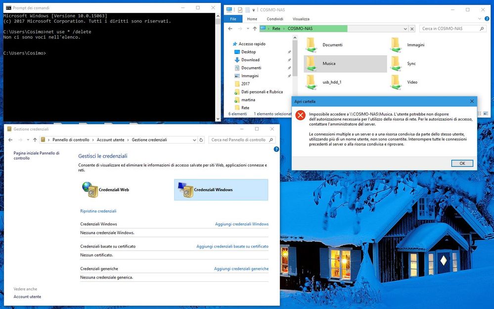

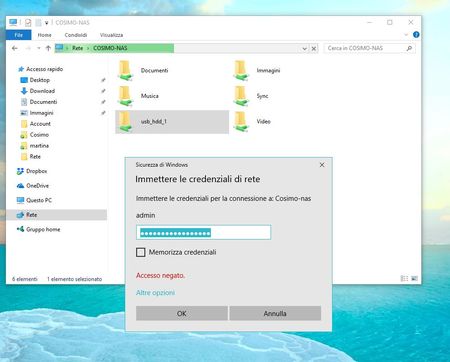

I've done the following tryings:
1) run "net use * /delete" > deleted all the windows credentials > restarted the system > result: doesn't work (see attached screenshot).

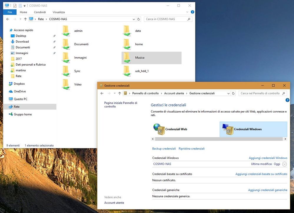

2) at this point as you say I've added new credential directly into the windows credentials (using as adress of the device the file explorer address "\\COSIMO-NAS" and not the IP) and this time it works! I'm logged as "admin" (see attached screenshot).
So, I still do not understand why the access with password works on the laptop but not on the PC, but, at least, now I know two different ways to make it work. Now I will restrict the access to the other folders only at the admin and at the readycloud user.
Windows treats connections using the hostname (COSIMO-NAS) and the IP address as going to two different machines. So if you access the NAS using either the hostname or the IP address you should set credentials for both.
Note that you can actually use different credentials for the hostname than you use for the IP address. For instance, you could use admin for the IP address, and a different NAS account for the hostname.
